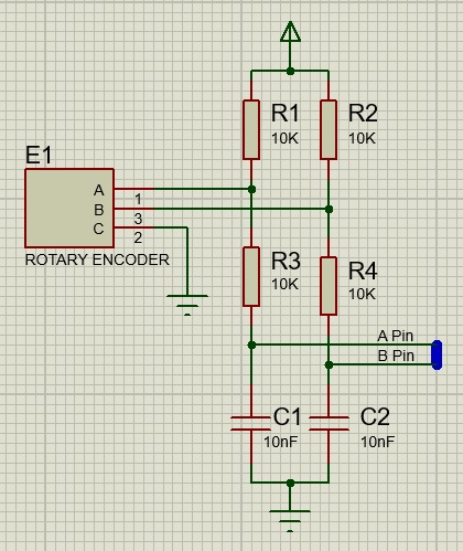

Mechanical encoders can be a bit electrically noisy when switching and so to have reliable operation it is recommended to have a simple filter as shown here.
