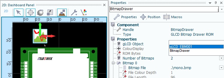

The Bitmap Drawer component must be linked to the graphical LCD using the gLCD Object property.
Here is an example which loops drawing a monochrome and 24-bit bitmaps to the EBM001 graphical display.
