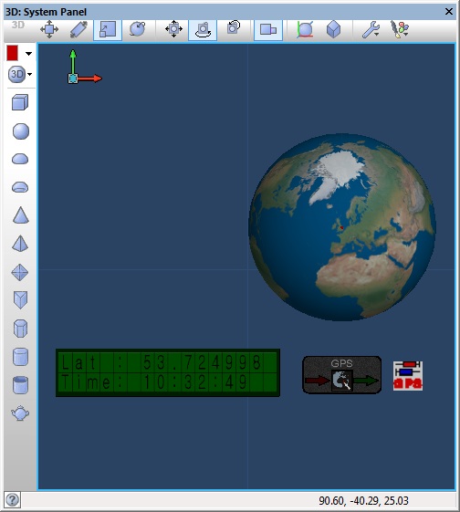

Example should show the Latitude generated by the GPS injector as well as the system time in simulation or UTC time on hardware.

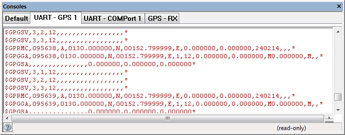

Example data provided by the GPS NMEA injector component
