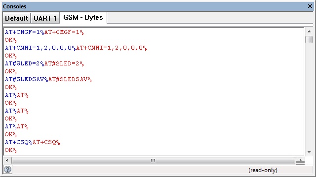

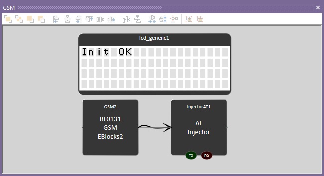

GSM Example File GSM Example Example should show the following on the display on the panel and on the hardware.
The AT injector component allows us to simulate the response of the GSM module.
