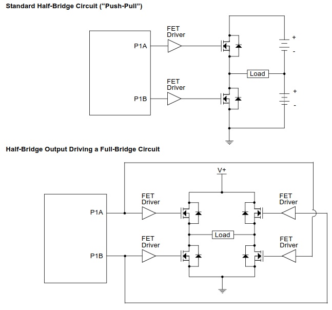

Half Bridge Application
A Half Bridge type output has two output signals A and B.

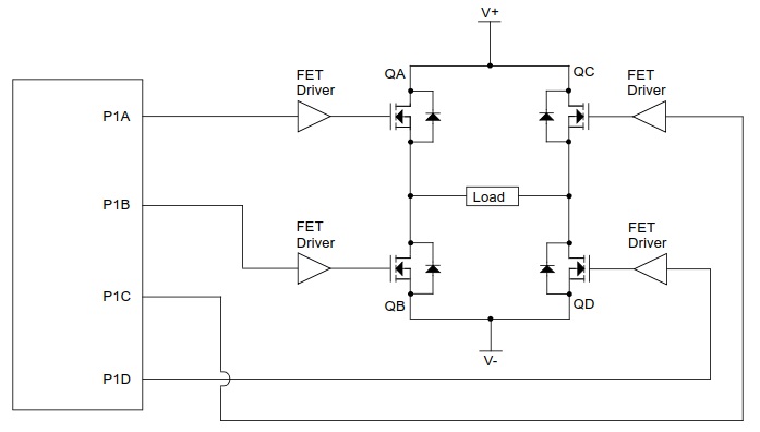

Full Bridge Application
Full Bridge type output has four output signals A, B, C and D.
