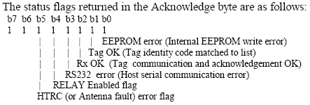

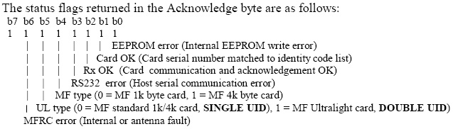

The status of the RFID module is read using the "GetRFIDStatus" macro which returns a byte which is then displayed using the PORTB pins. RFID Status Status byte breakdown for Mifare.
Status byte breakdown for ICode.

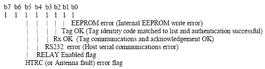

Status byte breakdown for HiTag.

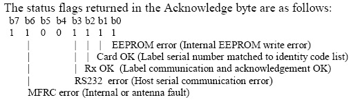

Status byte breakdown for EM Marin.

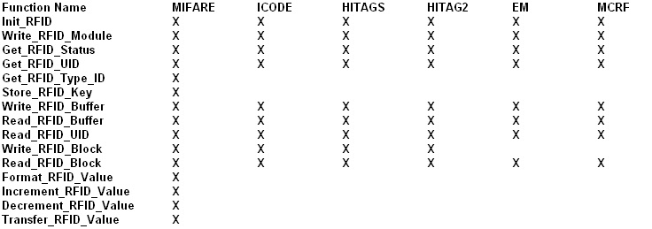

Macro compatibility
Not all the macros can be used with all card types, here is a list of RFID transponder types and the macros that are compatible.
