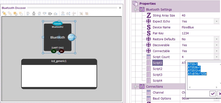

Bluetooth Discover
Script 1 contains the AT commands to setup the Bluetooth device to be discoverable with pair key "1234".

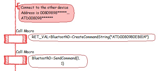

Connecting to a device
Example program to connect to a specific Bluetooth device address and send data to the device.
Bluetooth Connect
The device MAC address is specified using the "CreateCommandString" and "SendCommand" macros.
