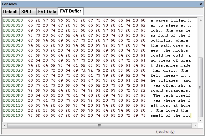

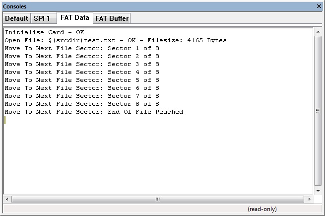

Console showing current 512 byte sector data
Console showing high level FAT status

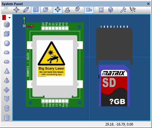

Demo bitmap files referenced in the example.
Picture showing a bitmap being displayed on a GLCD component.
