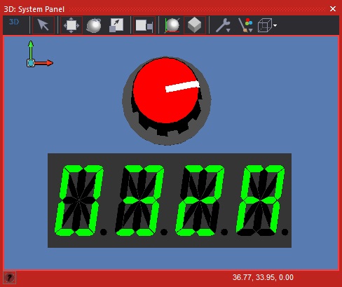

Example program showing how to use the starburst display component to display alphanumeric ASCII characters. FC6 Icon.png Starburst Test Example program showing how to multiplex between several starburst displays. Takes an ADC reading and displays the reading in decimal using 4 starburst display components. FC6 Icon.png Starburst Multi Example program showing how to multiplex between several starburst displays. Takes an ADC reading and displays the reading in hexadecimal using 4 starburst display components. FC6 Icon.png Starburst Multi Hex StarBurst.jpg
