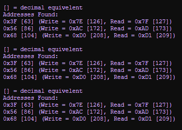

If the display is not showing the expected characters, the I2c address or contrast could be wrong.
It's best to keep the jumper connected since the backlight is enabled by default.
Using an Arduino Uno the correct I2C address can be determined by using an IC2 Address Sniffer
The I2C address to use is the one within the first set of square brackets.
For example, with my backpack display, the correct address to use is 0x3F [63]:
The other two Addresses i.e. 0x56 [86] and 0x68 [104] is for my 24C32 EEPROM and DS3231 RTC respectively.
Note The I2c addresses scan will repeat every 5seconds.
The sniffer will send data to your PC via UART to USB.
The Arduino range and clones will have it built-in.
