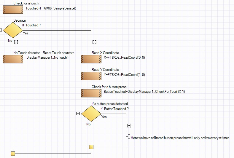

Touch Repeat Rate for Button Widgets
The Touch Repeat Rate property applies to button based widgets and sets the frequency that a valid touch will be detected for a held button. This is similar to holding down a single key on a keyboard and acts to reduce the frequency of positive button detections when touching the button. For example if you had a button that incremented a value, without the repeat rate the value would increment much faster then anticipated in an uncontrollable manner. When no touch is detected it is recommended to call the NoTouch macro to clear the touch counters and allow a more responsive user experience.
Example of implementing touch repeat rate

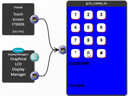

Keypad Example
An example showing how you can use the CreateWigitArray component to create a touch keypad for your gLCD.

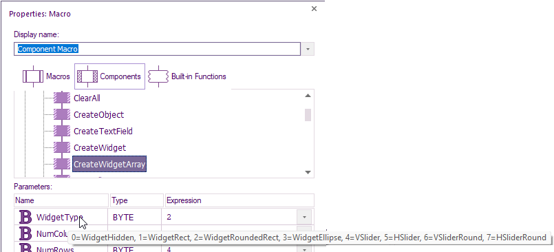

The CreateWidgetArray function macro has a number of parameters to allow high flexibility in what you can create:
There are also tooltips for each parameter to help.

How the key touch is detected
The first widget is automatically assigned a unique widget ID e.g. the first widget with text 1 on it is assigned 24.
All the following widgets ID is then incremented from 24, e.g. widget with text 6 on is assigned 24+ 5 = 29.
The widget button pressed can then be calculated from 29 – 24 + 1 = 6.

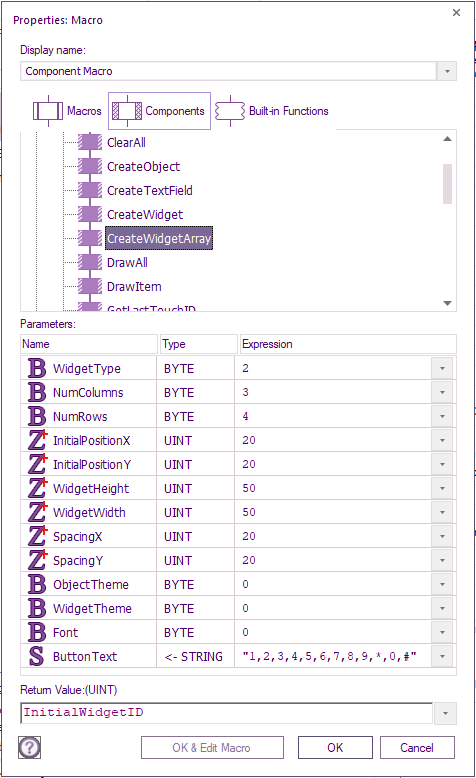

CreateWidgetArray
CreateWidgetArray
Creates a 2d array of buttons that can be used to create things like keypads.
Returns the ID of the first button, the following buttons have incremental IDs going column by column and then row by row.
- BYTE WidgetType
0=WidgetHidden, 1=WidgetRect, 2=WidgetRoundedRect, 3=WidgetEllipse, 4=VSlider, 5=HSlider, 6=VSliderRound, 7=HSliderRound, 8=Bitmap
- BYTE NumColumns
Number of columns of buttons in the array
- BYTE NumRows
Number of rows of buttons in the array
- UINT InitialPositionX
X location of the initial button
- UINT InitialPositionY
Y location of the initial button
- UINT WidgetWidth
Widget width in pixels
- UINT WidgetHeight
Widget height in pixels
- UINT SpacingX
Horizontal spacing between the widgets
- UINT SpacingY
Vertical spacing between the widgets
- BYTE LineWidth
Number of pixels thick to draw outer border lines
- BYTE Colours
, Hl Colour RGB [9-11]
- BYTE Font
Font used for the widgets text
- STRING WidgetText
A comma seperated text field with the text for each widget e.g. "1,2,3,.."
- BYTE DrawHighlight
Draws the highlight on buttons, also used for thumb width on sliders
- UINT Return

NoTouch
NoTouch
Called when no touch is present,
Allows the repeat rate counter to be cleared allowing for better responses to fast touches.
- VOID Return
