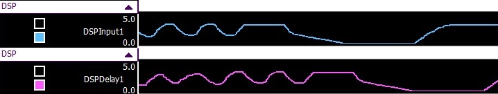

Here is a picture showing the response of the delay component using the data recorder window.
