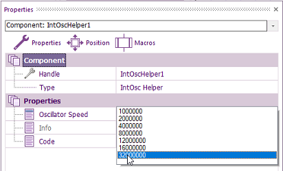

The oscillator speed drop down menu shows you what speeds are available on your device. Use this to select a speed.

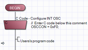

Once you have chosen your required internal oscillator speed copy the code from the Code property.
Paste the configuration code into a C icon at the top of your main macro.

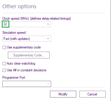

Next change the clock speed in the project options to match your oscillator speed. This will ensure that delays and baud rates are calculated correctly.
If the clock speed is not available as a dropdown value, then you can manually enter the speed value.

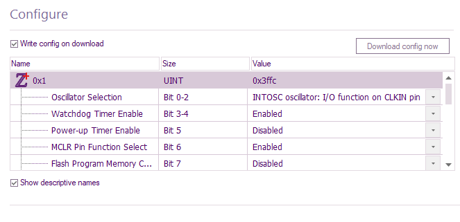

Finally, you need to enable the internal oscillator in the configuration settings.

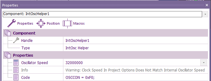

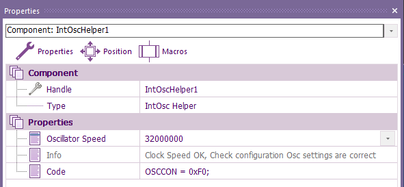

If everything is correct then the Info field should confirm that the project options clock speed matches the current speed selection.

Oscillator Speed
Shows what internal oscillator speeds are available on the device and allows the user to select an option.
Info
General info to the user, checks to see if the selected oscillator speed matches the project oscillator speed.
Code
Code to configure the internal oscillator module. This code must be added to a C icon which should be placed at the top of main.
