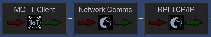

The MQTT component requires connection to a Network Comms component via the "Network Component" property, to provide the bridge for simulated TCP/IP communication.
The Network Comms component can then be linked to an embedded TCP/IP component to provide embedded TCP/IP support.
Here is a typical setup for using MQTT on a Raspberry Pi.
