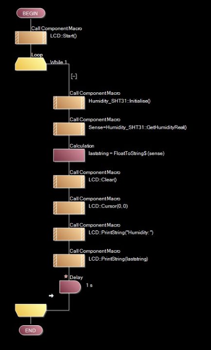

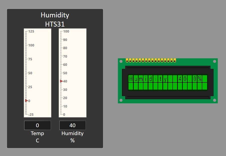

Well I suppose I have missed something from my test flowchart that is preventing the SHT31 sensor component displaying correctly under simulation. I thought being a true 12C component this would be easy to get functioning but the simulation is showing all zeros. Can someone pls put me right. I am reading the humidity into a float, doing a float to string and then trying to print the string on the LCD. I have initialised the sensor and ensured that it is the correct default address and I'm using the C3, C4 I2C lines from the PIC for the data and the clock. Tried changing the baud rate but makes no difference.

Quick question .... is the flowcode chart working for you then? You are using Flowcode 9 right? I'm using v8 and I can't get the LCD simulation to show the data from the sensor. If it's working for you then it looks like the sensor and/or the I2C code has been updated. It definitely doesn't work on v8. With your modification the LCD is showing 65530
Edit: Just tried on my v9 latest update and it does not work. Even more mystifying is why the LCD initialises by showing the digits 5530 on a clear screen macro command. This is definitely wrong somewhere. Can someone please load the flowchart and see what it is doing on the LCD sim display?

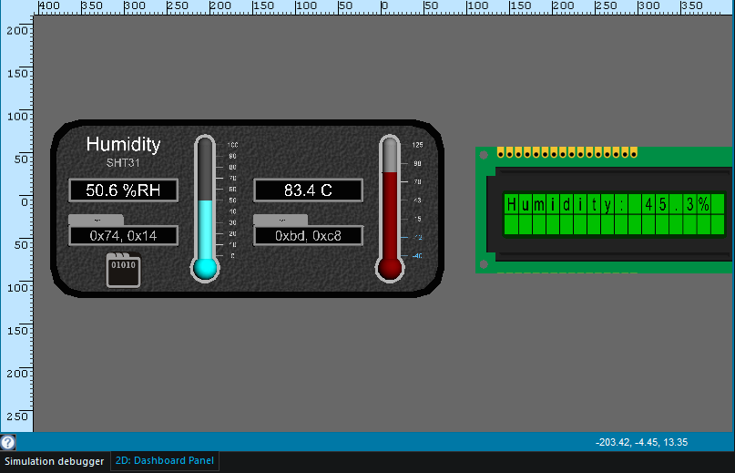

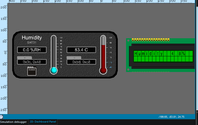

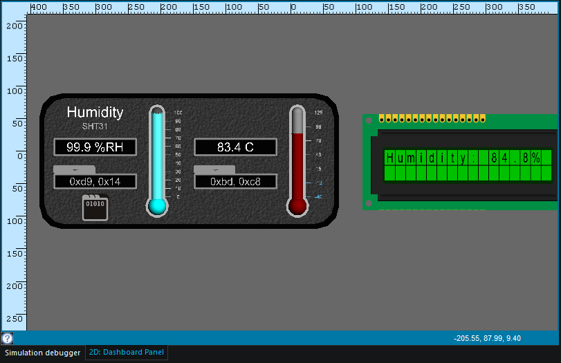

Thanks for the assistance. I confirm the flowcode is putting out values on the LCD but can you please confirm from my attached screen shots if your system is giving the same values on the LCD relative to what is shown on the SHT31 component? The LCD output and values of the SHT31 are offset i.e they don't match on my system. To be specific the LCD is displaying correctly the value held in the float variable 'sense'. Somehow the value of the data coming from the sensor and being read into the variable 'sense' doesn't reflect what is being shown on the SHT31 component. Have also tried the flowcode on a PIC18 device and getting same results. Shouldn't the LCD match the values shown on the sensor? Perhaps the I2C and/or SHT31 have been updated and my system has missed the update? Would be grateful if you could confirm what you're getting on your simulated display.
Thanks in advance
EDIT:
Just substituted the SHT31 component with the 21 and the simulated LCD works perfectly so does that implies there's a problem with the SHT31 model?
Thanks in advance
EDIT:
- 0 per cent humidity.png (96.39 KiB) Viewed 6126 times
- 50 per cent humidity.png (96.32 KiB) Viewed 6126 times
- 100 per cent humidity.png (96.57 KiB) Viewed 6126 times

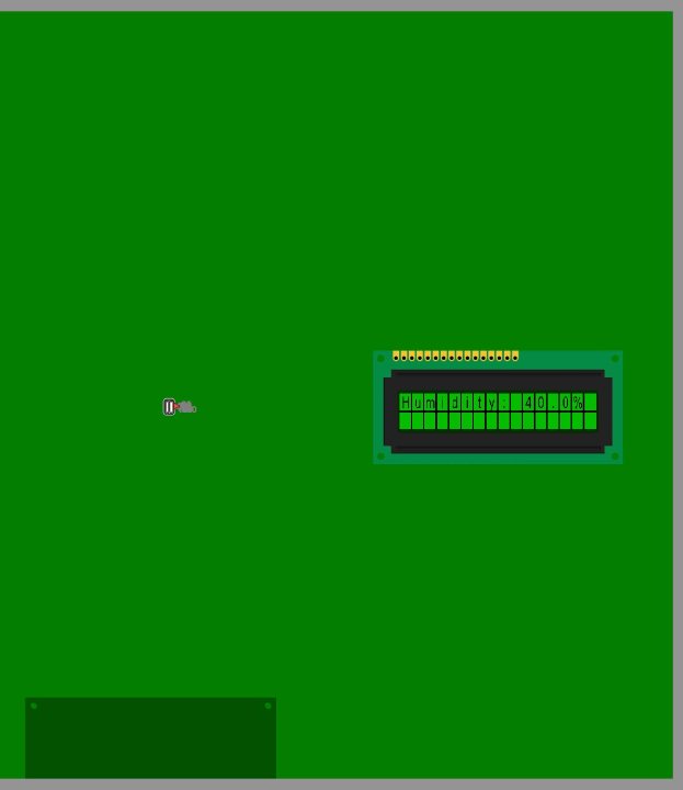

Martins FC9 program is working nice on my computer
I also have a sensor board here from DF robots with a SHT31. I can also do a few measurements on an ESP32 if that helps you
Working FC9 Programm: But the another program (from you) has no display and an another SMT31 component.

The simulation model is a few % out, but the hardware should work accurately.
If using the FC8 project on FC9 then you will need to resize the sensor, but the simulation and hardware % should be correct.
Thank you Stefan for your testing.

The simulation does work perfectly in Flowcode 9 here.
Thanks for the support.
