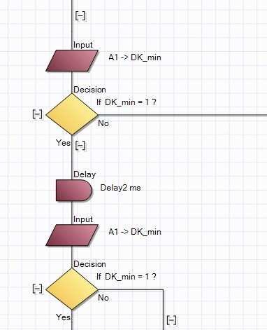

Hi there,
Yesterday I have tried to post an update but it seems to be disappeared.
I read about the debounce only be available with the Component Macro's.
So I did change the buttons macro to that.
In the attachment are the old (V001 - Input) and new (V002 - Macro) versions.
However, I still have mistakes in the counting.
I have put the debounce time on 40mS and later 100mS.
Still, every fourth or fifth time the value changes with more than one.
In the V002 version I have also included "Wait Until Low"
In an older program I checked an input and waited a while.
Than check it again and if it's still high, than react.
This was meant to avoid spikes but it might be better do debounce?
Please let me know your opinion.

Re: E-Blocks 2 settings
This is the debounce routine for the switch read functions: if you believe the debounce is not working then we will investigate further.
You need to rememberr that the code within a microcontroller is accessed so fast, delays or WaitUntilHigh or WaitUntilLow (depending on the polarity.), will be required to prevent switch being read too quickly
