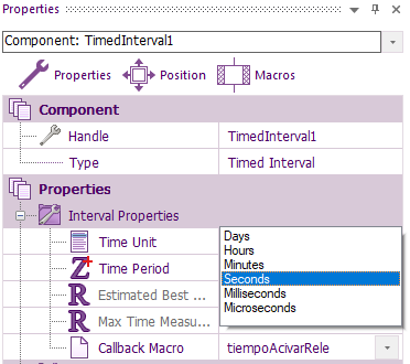

Rather than a timer interrupt, for better timing control on your hardware and simulation there is the Timed Interval component (Component Libraires > Math > Timing).
The advantage is you can enter an amount, directly in:
Timed Interval component.png (21.37 KiB) Viewed 5427 times
Therefore, you can enter 1, 20, 300, 4000, 55689, 6000000 etc microseconds, ms, seconds, minutes, hours or days
So much more easier to set up than a timer interrupt.
