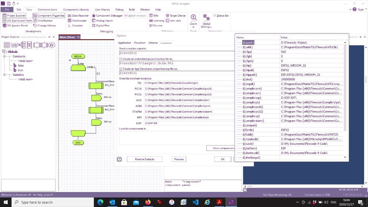

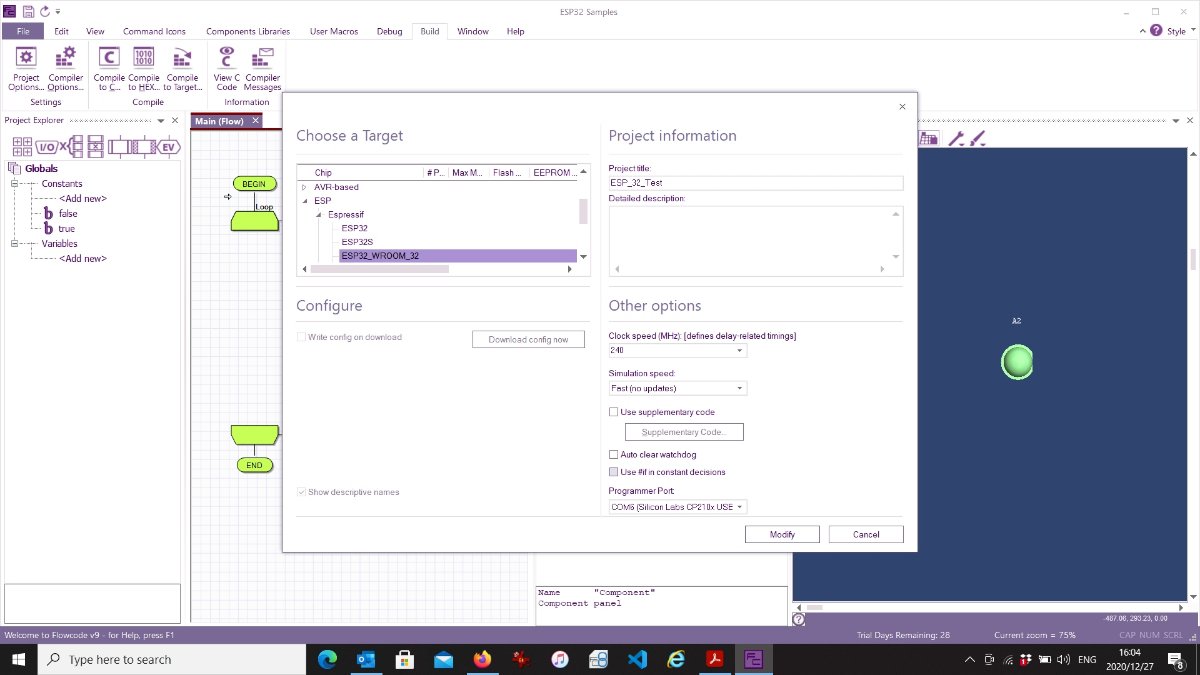

My Comport setting in the Global Setting Under Options is empty, how do I edit it?

You will need to have the board plugged-in to your PC before running Flowcode.

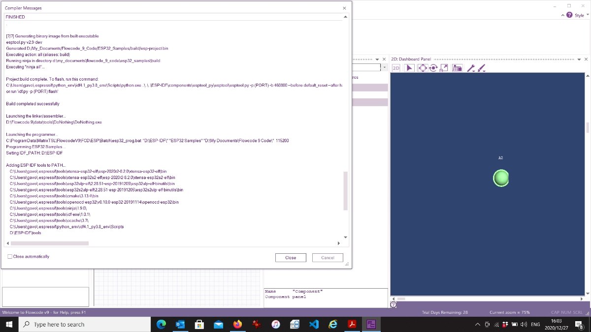

Hi Martin/Leigh,
Please see below
Try 'idf.py --help' for help.
Error: Invalid value for '-b' / '--baud': flash is not a valid integer
Programming Failed
C:\ProgramData\MatrixTSL\FlowcodeV9\FCD\ESP\Batch\esp32_prog.bat reported error code 0x1

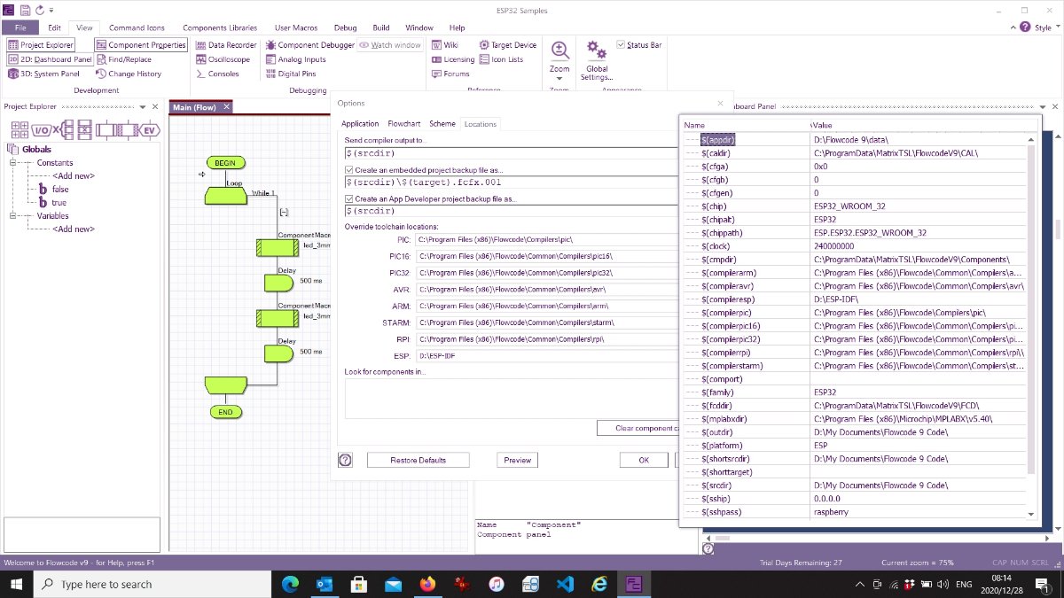

I have followed the post and done exactly the same but when I check in Global Setting under location the Comport Field is empty?, you can see that below, no matter how many times I select it in Project options and save and then exit, I can't seem to populate this field. I tried it on a second PC with the same result

Here the whole log

Launching the programmer...
C:\ProgramData\MatrixTSL\FlowcodeV9\FCD\ESP\Batch\esp32_prog.bat "D:\ESP-IDF\" "ESP32 Samples" "D:\My Documents\Flowcode 9 Code\" 115200
Programming ESP32 Samples ...
Setting IDF_PATH: D:\ESP-IDF
Adding ESP-IDF tools to PATH...
C:\Users\gavo\.espressif\tools\xtensa-esp32-elf\esp-2020r2-8.2.0\xtensa-esp32-elf\bin
C:\Users\gavo\.espressif\tools\xtensa-esp32s2-elf\esp-2020r2-8.2.0\xtensa-esp32s2-elf\bin
C:\Users\gavo\.espressif\tools\esp32ulp-elf\2.28.51-esp-20191205\esp32ulp-elf-binutils\bin
C:\Users\gavo\.espressif\tools\esp32s2ulp-elf\2.28.51-esp-20191205\esp32s2ulp-elf-binutils\bin
C:\Users\gavo\.espressif\tools\cmake\3.13.4\bin
C:\Users\gavo\.espressif\tools\openocd-esp32\v0.10.0-esp32-20191114\openocd-esp32\bin
C:\Users\gavo\.espressif\tools\ninja\1.9.0\
C:\Users\gavo\.espressif\tools\idf-exe\1.0.1\
C:\Users\gavo\.espressif\tools\ccache\3.7\
C:\Users\gavo\.espressif\python_env\idf4.1_py3.8_env\Scripts
D:\ESP-IDF\tools
Python requirements from D:\ESP-IDF\requirements.txt are satisfied.
Done! You can now compile ESP-IDF projects.
Go to the project directory and run:
idf.py build
Usage: idf.py [OPTIONS] COMMAND1 [ARGS]... [COMMAND2 [ARGS]...]...
Programming Failed
Autoclose turned off
FINISHED
