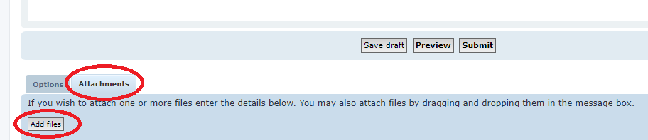

- Posts: 458
- Joined: Mon Dec 07, 2020 1:00 pm
- Has thanked: 82 times
- Been thanked: 246 times
Re: Flowcode not communicating with Hardware
As Steve mentioned ...
Which can be uploaded via the button ...If there are any problems during this procedure, they will be displayed in the output text, which is also stored to a file with the suffix ".msg.txt"
