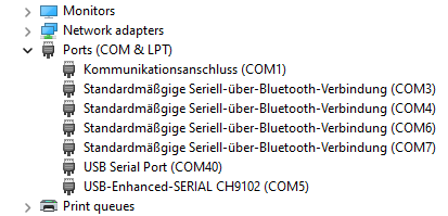

The Comport from different USB ports or BT devices can be easily detected by FC10.
It also selects the correct com port and does not use the unusable second comport, from the SPP connection.
That is already super good.
Unfortunately, you can't search for two identical modules, it always finds only the first one, for example just from first Microchip BT Modul,
but there is no information about the second Microchip BT Modul comport number.
I have now connected the second sensor to the another device with the first sensor using a cable, so I only read the data via one BT connection.
This also works and perhaps causes fewer problems than two BT modules.
Here the list of comport: and the correct dedection from FC10

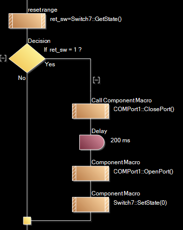

In my program I add a switch to open the comport from a Bt modul (Microchip RN4677)
If I use ClosePort and then OpenPort I can press the switch 100times no problem.
But if remove the ClosePort and just open the port twice ( i mean open an open port) something crash very bad.
I have to remove the BT device and sometimes also restart the computer.
So before i open a port with bluetooth i always close the port first.
I suspect: Better close the port before opening it
It has worked well when there is only one module, but certainly I would like to search via the BT address if possible.
Another small experience with Bluetooth

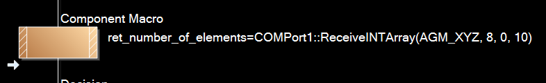

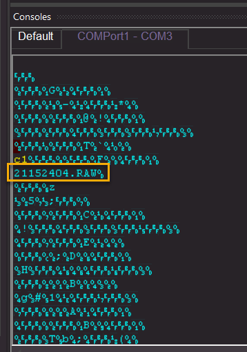

One more question.
From the bluetooth device I always get an array with 8 integer, i.e. 16byte data.
This works very well and quickly and the display in the app seems to be real time.
But once I also get the filename with 12char as a string, i.e. 12byte.
How can I separate the received data?
Can I somehow read how much data is in the buffer before I read as array or string?
Thanks a lot.
One more question.
