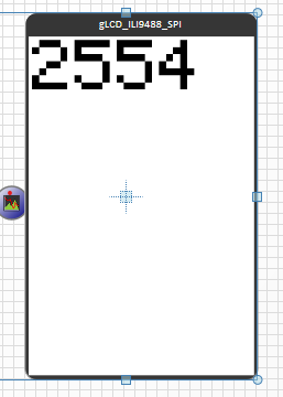

This is what the display shows when I run your project file:
That looks correct to me

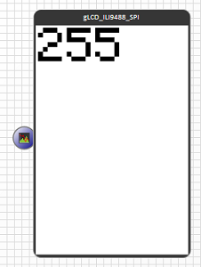

I have run the full library update as instructed and the ClearDispaly() macro is still not working. I have also corrected the transparency issue.
This is the output I get when I run the code.
