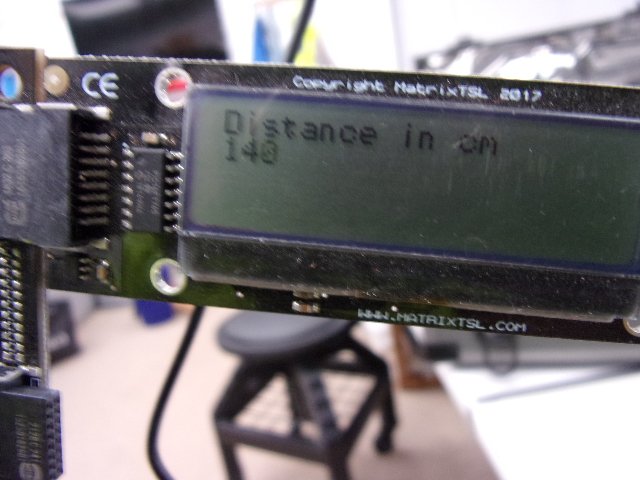

Set up a little test rig to measure distance from sensor to target. Rig holds the sensor at 90' to target, vertically, with very impressive results for such a module and my accuracy was greater than +/- 1% (bear in mind we count in cm).
These images show measured at 117 with reading of 118 (sorry, can't figure out yet how to rotate).

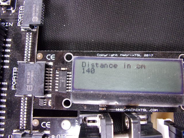

Reaching 140cm all was still good, reading showed nothing of concern.

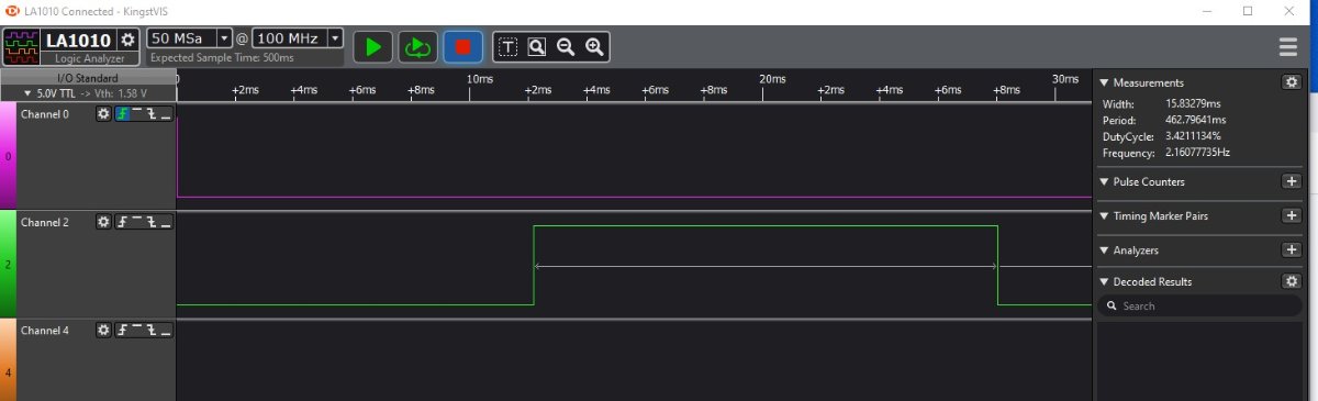

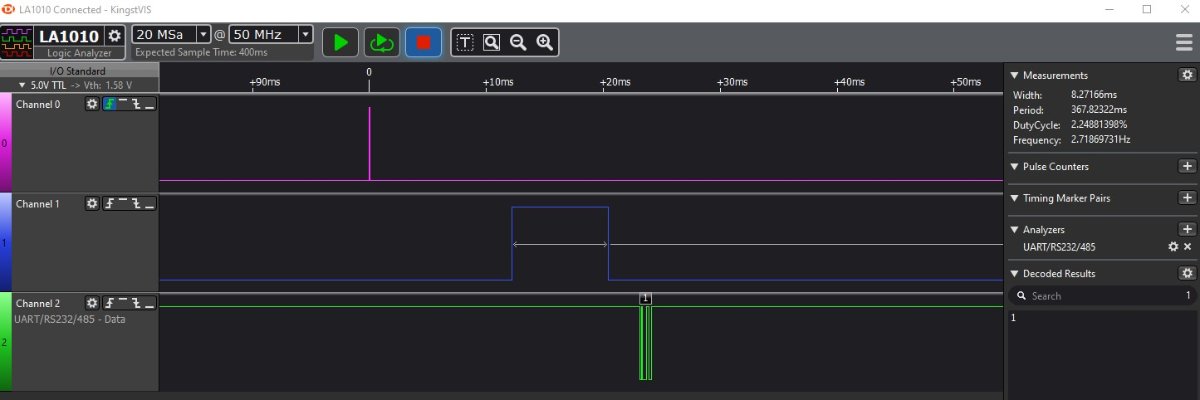

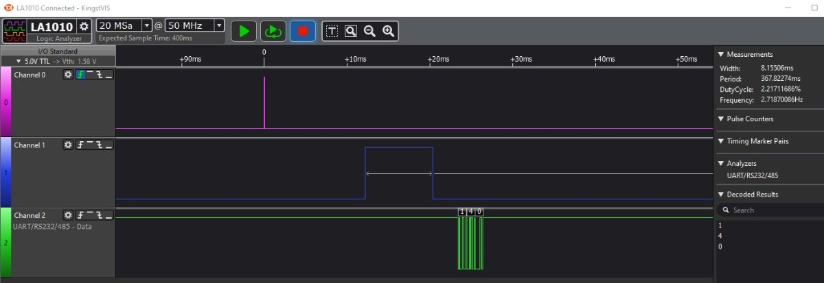

Attached are reading and pulse trace.

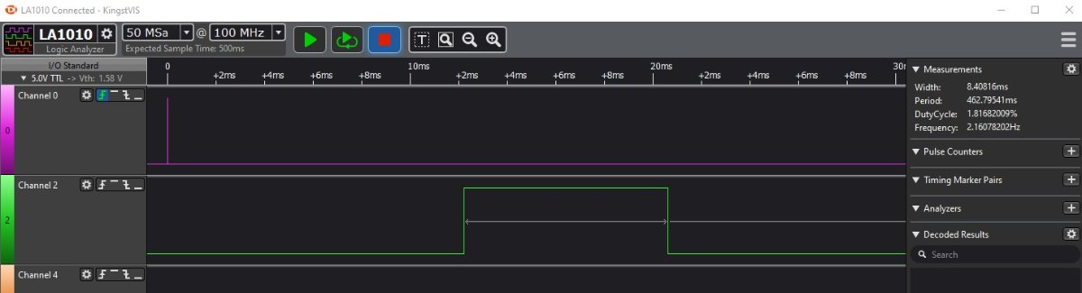

Now the fun begins. At anything above 140cm the readings start again at zero. At a measured 144cm the readings return 4cm. The pulse width suggests that not to be the case.
If I hold a clipboard underneath the sensor it returns the distance to target, but once above 140 it starts again from zero.

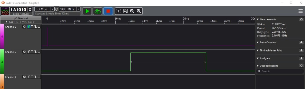

This pulse is at 190cm with reading showing 50cm
This is measured at approx 270cm. Reading shows 132 (if you add in 140 then it's still with +/- 1%)

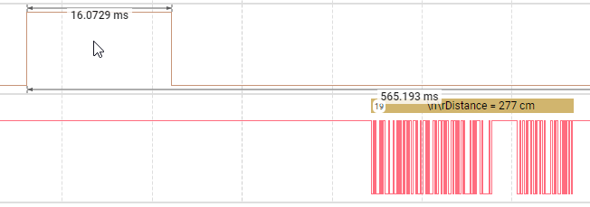

I have just tried the sensor at greater distances.
Results for 277cm: I have noticed that reflections on nearby objects affects the reading the great the distance which is expected.
I.e. the further the object the wider the band.
What I would recommend is do what did, also have UART output that states the distance so both distance reading and pulse width can be matched together.

In the traces above they document 8.xxxx / 11.xxxx / 15.xxxx mS which equates to roughly 1.4M to 2.7M, but at no time did the display ever show anything above 140cm before starting again at zero.

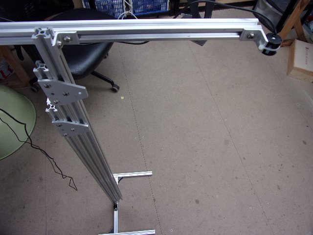

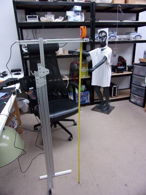

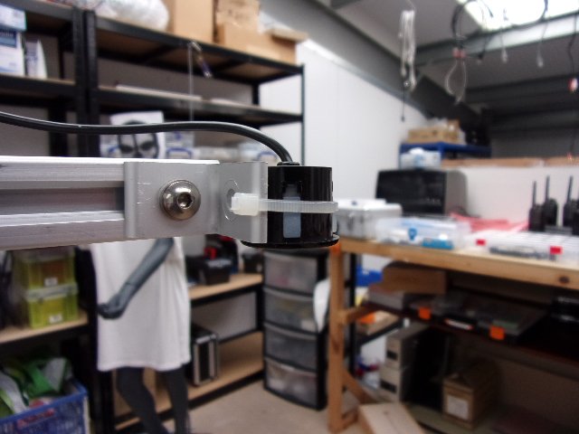

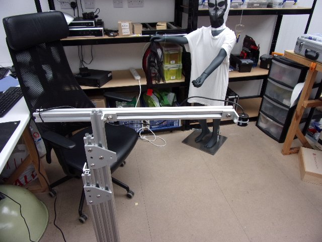

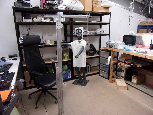

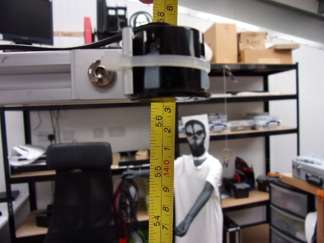

Picture of test rig with sensor pointing to floor. This reads 114cm on display / UART with pulse width of 6.628mS

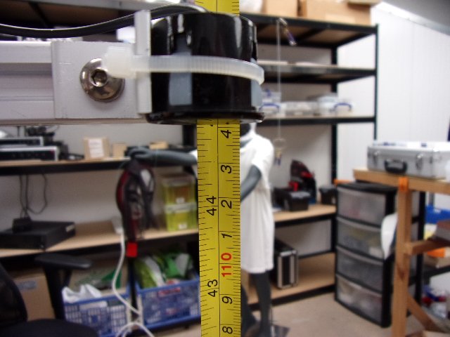

Next is at 140cm with a pulse width of 8.15506mS

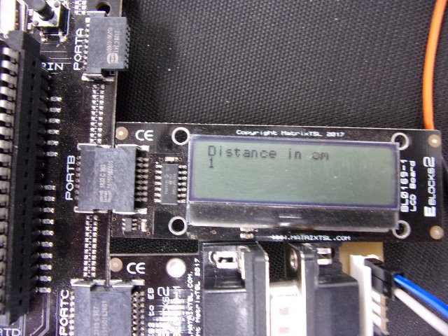

Now we read 1cm with a pulse width of 8.27166mS
The tape measure is only added when I physically measure the distance, nothing else in near enough to interfere, you can see there is nothing 1cm below sensor and pulse width has increased, not decreased.
