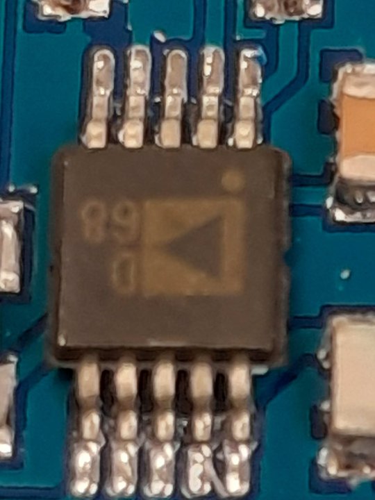

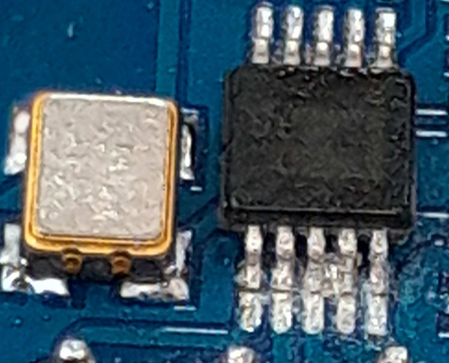

Further to above posts I tried to get both modules running using Martin's code, again as a known good example.
Not a great success. If I had either module connected all went well but when both were connected, module 1 just went crazy. It didn't matter if I swapped CS pins. Either worked alone but when both were connected module 1 wasn't happy.
Further testing showed that the CS pin on module one was constantly held low, meaning any and all activity on the SPI pins would be getting through whether intended to or not. Looking at the module through a magnifying lens it appears there is a solder bridge behind the chip pins.
New on order.

Hi Kersing
I did check thanks, and the other also appears to be soldered better too. Guess this one fell through whatever passes for their QC...

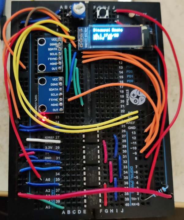

Managed to get a 'prototype' working.
Actually second attempt - first didn't give an output on oscilloscope (and I was using the digital inputs and 655mV wasn't enough. Realised after much testing of SDATA, SCLK and FSYNC - then pulling it apart and putting it back together - oh how we laughed!)
I have a potentiometer to set frequency (actually the value from the ADC fluctuates - so any suggestions as to avoiding frequency changes (second button?)) The pot was the first that came to hand (1k)
The button - top right - changes program alpha-beta-theta-delta. I use Martin's excellent Map component - to map 0-5V to 20 - 20000Hz (and assume the pot gives 0..5V) - both assumptions (that the pot is perfect and that I have the ears of a bat) may be false I 'experimented' with the value to test the change against before changing frequency.
i2c display shows current program and frequency.
Probably should use an inbuilt pull-up/pull-down resistor on D2 rather than the resistor (first to hand) connected to ground (but this would make the code AVR specific) Pin 8 - is set high and provides power for the switch.
Headphones to attach to both OUTs and one AGND.
Note - I linked all the pins on the two ad9833 modules except FSYNC and OUT - colour of wire only signifies length
At the bottom is my i2c memory bank for Arduino - I'm not brave enough to take it apart - so space a little limited by this...
Oddly - both ad9833s now seem to give 5v (actually 6.6v which is odd!) on sine wave and the signal is much 'noisier' than it was? This is suspiciously like 10 x 665mv - but not sure what I changed on the 'scope.
Next flashing lights. Or maybe a little lie down?

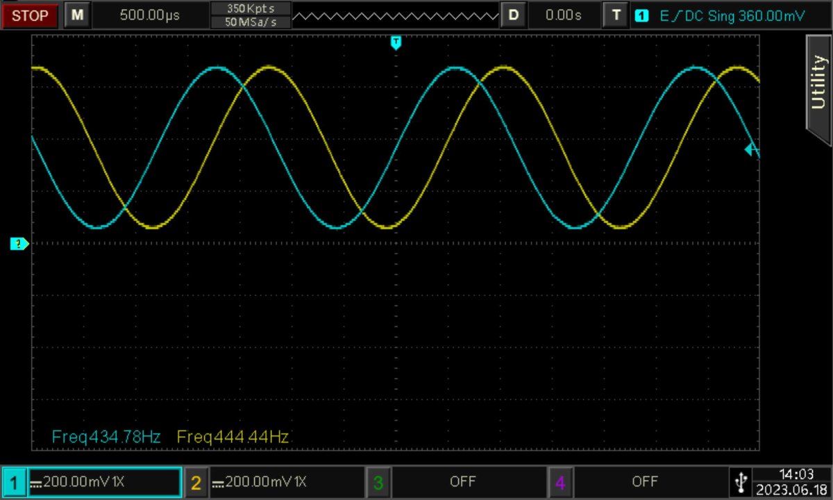

My new modules arrived yesterday.
A bit better quality than before
I put proper headers on them and tested both individually, working OK straight away with known good jumpers. I then connected them both up, much like you did and downloaded some of my own code I was using to test with.
However I still had problems with the first module (connected to Ch1 of scope). I could not get a trace on that channel at all. Swapped modules over but nothing at all. Problem down to lack of colour perception.... On both modules I'd used yellow/green jumpers for Analogue Out / Ground but on Ch1 I'd connected probe to green and ground to yellow... I won't tell you how long that took to figure out....
Once connected correctly I could then obtain traces on two modules (delta 10Hz) being accessed via separate CS pins.
I'd set ch1 for 435Hz and ch2 for 445Hz but now being pushed for time I just grabbed a quick single shot.

Did you accidentally switch the Probe to 10x or tell the scope you were using a 10x probe or the like?
