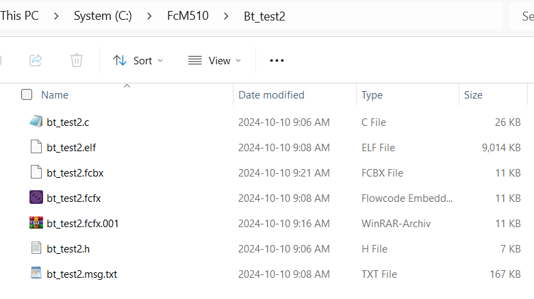

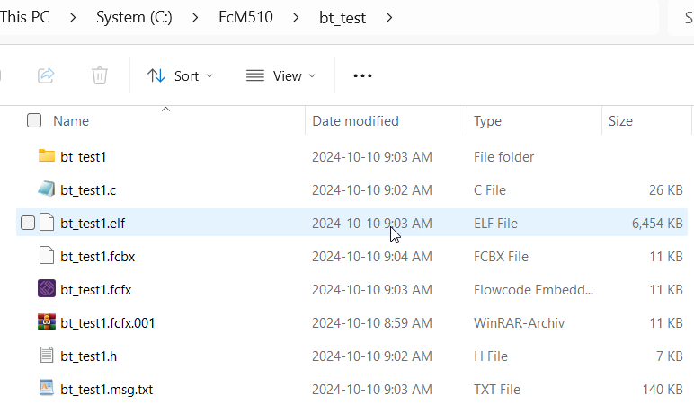

Re: ESP32 Wroom32 Bluetooth no longer works
After the last update from ESP32, a new project creates only a few files and no folders
That's an advantage and I like it.
But then Bluetooth SPP doesn't work anymore because I can't make a menu config.
And If menue config doesn't work, I can't make any clock settings either to save power set the clock from 240Mhz to 80Mhz
To build a portable device with the ESP32 both settings are important.
I suspect it is a problem from the last update.
b4 the update: after the update: the update:

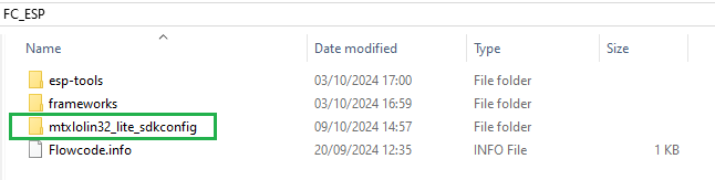

Hi Stefan.
The new updates have made the ESP32 a lot better and quicker, especially if using the same target device but changing the project name.
When you compile for the very first time with your new target, a folder will be created within the ESP toolchain root directory.
With the new toolchain it will be within FC_ESP
look for a folder with the target name and you should be able to use the menuconfig for all your projects that use the same target, even if you have changed your project name.
For example I used lolin32 lite and the folder that is created for that target:
