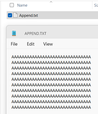

It works with the additional task to create.
In the additional task I can send UART and write to the sd-card.
I can also take over variables from the main.
I will try to place the saving of data to sd-disc in an additional task in my program.
Special I had to increase the stack size to 10240
File is ok:

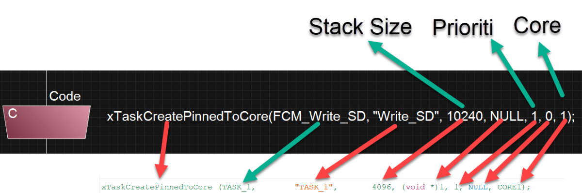

One more question.
It works with the task and writing to the disk.
Only during writing, the sampling slows down.
Can I also run the task in the other core?
Posts: 2184
Has thanked: 177 times
Been thanked: 1026 times
Re: Esp32 Tasks - communication and control
Post by mnfisher »
I've never tried it - but xTaskCreate allows you to specify the priority and you could try increasing that.. You could also try xTaskCreatePinnedToCore - but the normal xTaskCreate should allow the task to run on either core - so this might not make much difference.
Make sure no tasks are busy-waiting (for pin change etc) - but yield and use a 'wait' procedure to pause until an event - as the system relies on tasks passing control back to the task-handler whenever possible.
Posts: 1290
Has thanked: 246 times
Been thanked: 257 times
Hi Martin
It looks like this is working :)
during writing, the sampling is not slows down! If the task is in core1 and not in core0
I will test it more.
