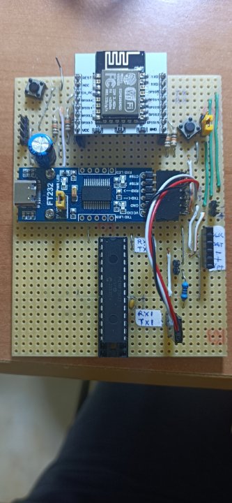

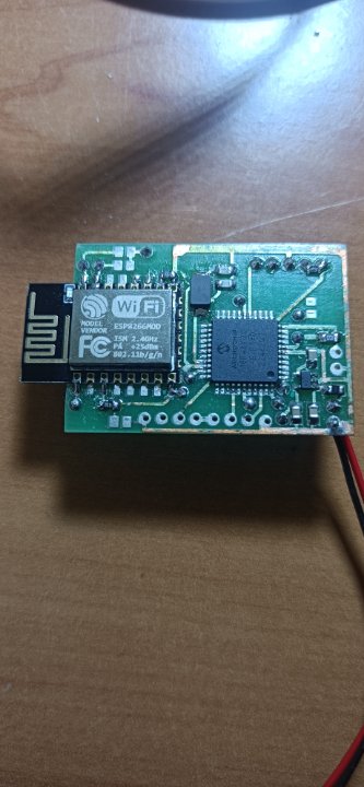

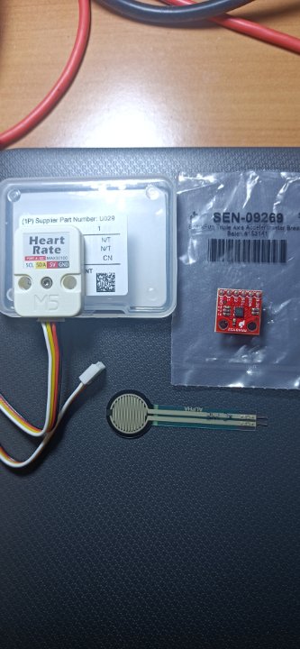

- Posts: 123
- Joined: Tue Dec 13, 2022 9:04 pm
- Has thanked: 32 times
- Been thanked: 2 times
Re: PIC18F25K22 UART ERROR
Below are some photo of hardware and sensors to take a look...I'll continue to try to find errors , or to use another component...I was added a force sensor (FSR).
- 1677521113843.jpg (86.41 KiB) Viewed 29342 times
- IMG_20230227_185656.jpg (85.77 KiB) Viewed 29345 times
- IMG_20230227_185238.jpg (95.65 KiB) Viewed 29345 times

My 8266's are a bit more basic than yours appear to be
I don't think the sensors are of any issue as I'm sure the interfacing will be straight forward.
What distance do you need to communicate over? I ask as I recently made a transparent Bluetooth link that would do as you require.
https://www.matrixtsl.com/mmforums/view ... 68&t=23028
I should get time to look at the ESPs in a day or so.
