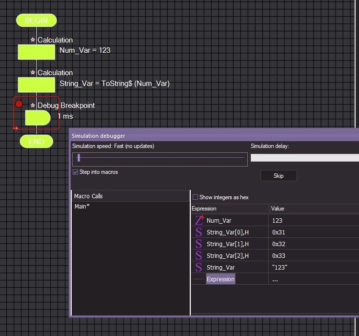

Hi Dirk
do you want to convert INT or Byte to STRING ( String is an ARRAY of BYTES)?
Just check this..
FC INT to String.jpg (95.85 KiB) Viewed 7008 times
S_V

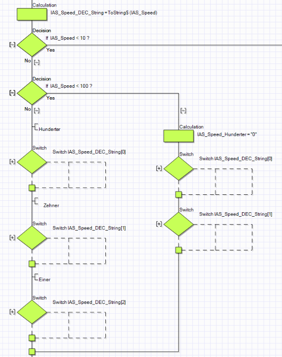

dvcam99
Posts: 109
Joined: Fri Dec 04, 2020 11:03 am
Has thanked: 9 times
Been thanked: 14 times
Flowcode v9 Re: Byte or INT number into a ASCII hex string
Post by dvcam99 »
Hello together,
many thanks for your suggestions. I will check it out.
In between I found a way to solve my problem. I used the string function "ToString$" too. After the function I used switch component in order to filter for string element 0-2. 0 is giving me the hundert, 1 is giving me the ten, and 2 is giving me the numbers smaller then 10. Each switch has ten ways.
Each switch way down is giving me the requried ASCII HEX.
Screenshot 2024-08-29 080847.png (102.85 KiB) Viewed 6977 times
BR
Dirk
Happy FC9, FC-8 and FC-6 professional user ;)
