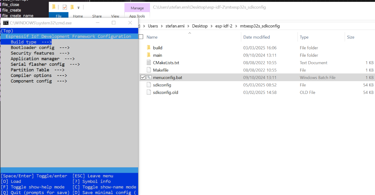

I have found this dir: C:\Espressif\frameworks\esp-idf-v5.3\mtxesp32s_sdkconfig and know from the past how to edit the menuconfig.bat
But what do I need to edit to get the Bluetooth on my ESP32_Wroom32 working?

You have to start the menuconfig.bat
Can You try to start this?

I know how to edit the menuconfig.bat, but what settings do I need to edit?
There are many settings for the Bluetooth but I can't see which I need to edit..

try these settings. Works for me on PC and Android
Classic Bluetooth SPP Protocol
