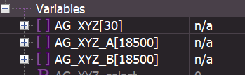

Assuming a buffer size of 1000 records - increase the receive buffer to 2000 records (note this might be adjusted to suit the 'save' task - maybe 1 SD card sector size?)
Then the read sends a notification to Save when pos == 1000 (save buffer_ 0 - buffer[0..999]) and pos == 0 (save buffer 1 [1000..1999) - the notification can wake the save task and also pass the buffer number to save?
Alternatively - using two buffers - requires a conditional in the read - but again notify the save task on 'full'...
Buffer Size for 1000 records 2x ACC xyz Gyro xyz in =12000

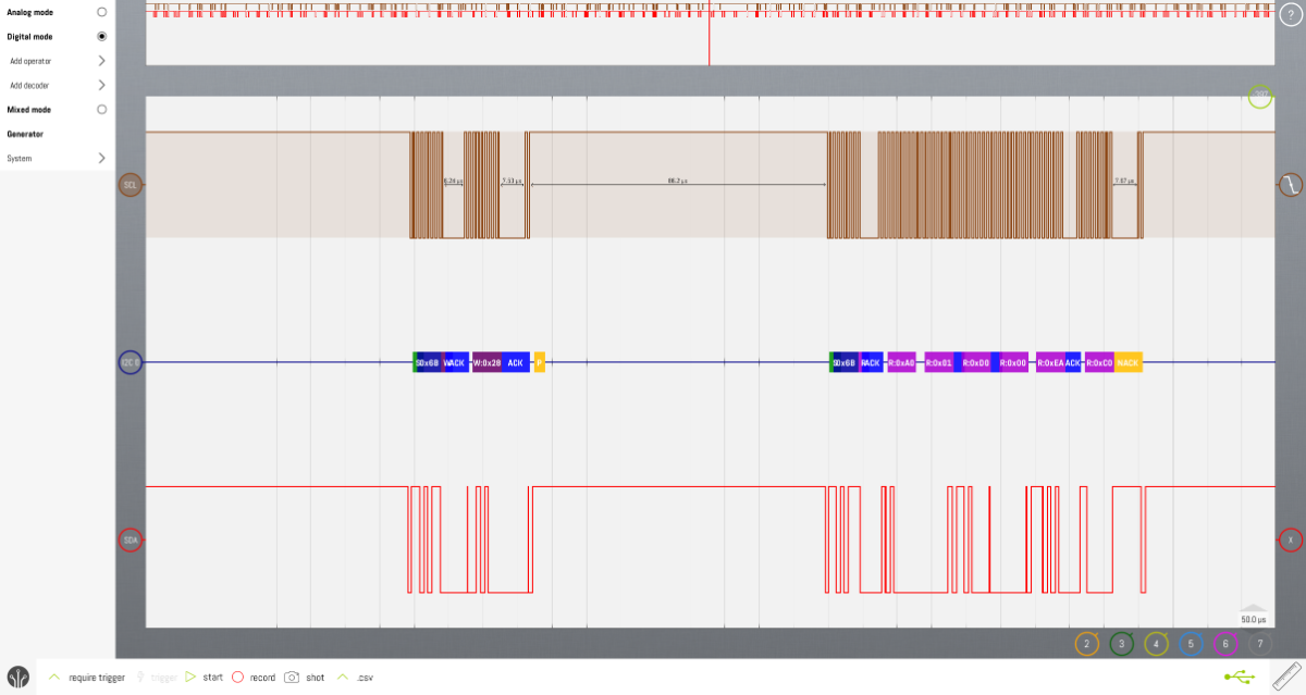

That's good 😃 Have the 'whiskers' disappeared from the trace?

Yes the 'whiskers' disappeared from the trace

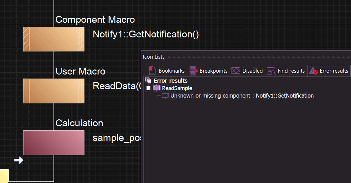

But I can't use it to sample data. I tried using the Notify component but that doesn't work either with my task.
With you task it's perfect!
I have not yet understood the Notify component exactly.
