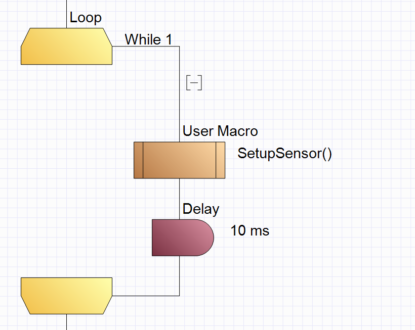

Not entirely sure why the wdt is getting fired - but in main() - you have a loop
Oops - sorry a bit larger than expected!
Which doesn't exit - is this intended? It has a delay - so wouldn't expect the wdt issue though (although the program won't progress?)
