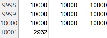

Here a program to test the SD-Card:
Press a key to start (GPIO19 on my board)
The program write 10'000 line in a .csv file
Its write a string of 128Byte for each line (21 times a fix number 10000,)
If writing is finish it's write the time in line 10'001 in mSec and it send the time to USB
Test_post_sd_0525.fcfx
(33.22 KiB) Downloaded 278 times
I tested with different setting for the card
the setting from the clock to 1Mhz, 20Mhz, 80Mhz is no difference
the setting 1Bit or 4Bit mode=> 1Bit=2935mSec 4Bit=2551mSec :)

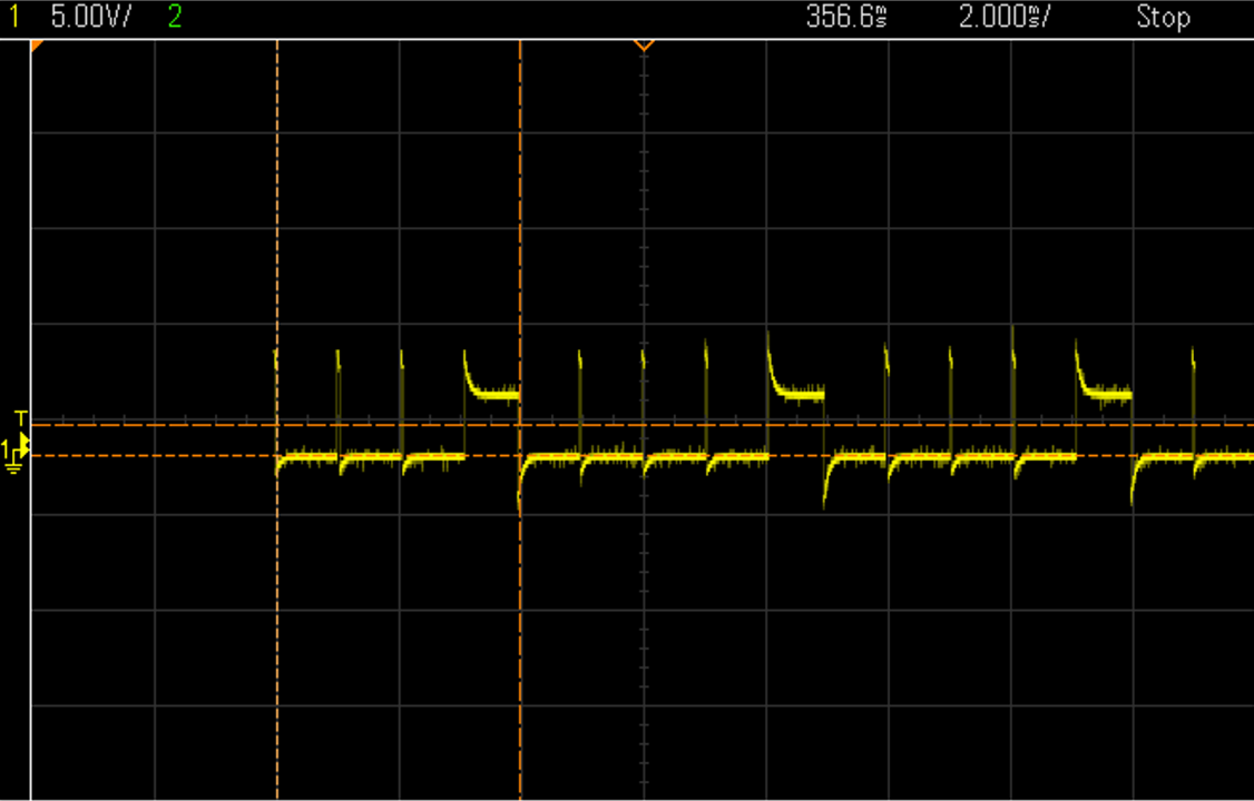

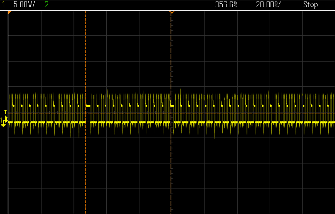

My wish is that the writing of 128Byte always takes the same time or that there is not such a big difference to write the string
test shows the time to write for 128Byte, you van see every 4te string is much longer ( with a 1mSec delay on)
here the 4te string
and sometimes it's much longer...

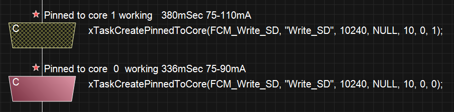

Re: ESP32 4Bit SD-Mode Init problem
Hi Martin
I testet the time to write one buffer (12000Byte) with the Oscilloscope with pinned to core 0 or core 1
pinned to core
0/1
to write a buffer with 12kByte it need
336mSec/380mSec
per second
35.7kByte/31.5kByte/
power consume Board
75-90mA/75-110mA
C-Code
