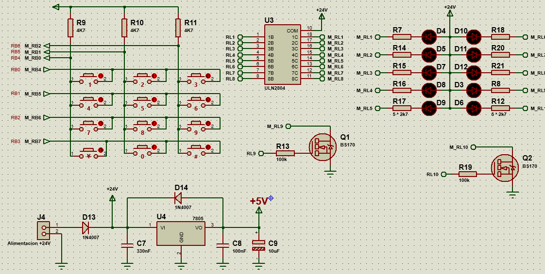

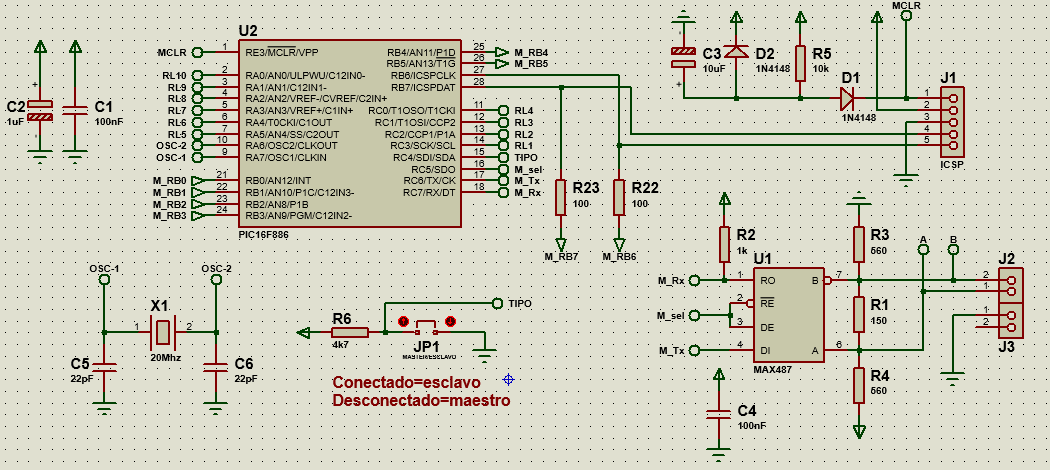

I have reviewed the entire assembly, according to the attached diagrams, and it is OK.

No funciona la comunicacion RS485, ni salidas digitales
- electrical diagram, output test section
- Salidas.png (63.55 KiB) Viewed 4126 times
