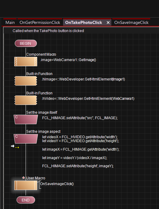

The attached is a small improvement. There is a new WebCamera fcpx component, and the ".fcweb" file is an example that sets the aspect ratio of the snapshot image to the same as the video and also saves the image (to the "Downloads" folder).

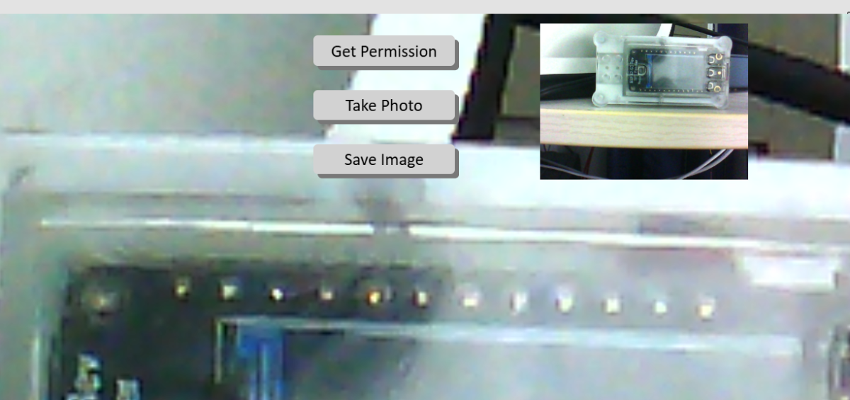

The buttons can also be placed in the image, also the photo you've taken can be smal in the imagel.
To save the photo immediately, all I have to do is enter the macro command.
Autosave:
The files are perfect.

The date is UTC. Here is some code that will hopefully set the filename to the local time. This will replace the code int he first icon in the OnSaveImageClick macro.
var currentdate = new Date();
//adjust for local time
var offset = currentdate.getTimezoneOffset();
currentdate.setTime(currentdate.getTime() - (offset*60*1000));
FCL_SFILENAME = currentdate.toISOString();
FCL_SFILENAME = FCL_SFILENAME.replaceAll("T", "_");
FCL_SFILENAME = FCL_SFILENAME.replaceAll(":", "-");
FCL_SFILENAME = FCL_SFILENAME.substring(0, 19);
FCL_SFILENAME = "PIC_" + FCL_SFILENAME + ".png"
The new lines are the 2 after the comment "adjust for local time".

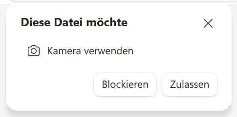

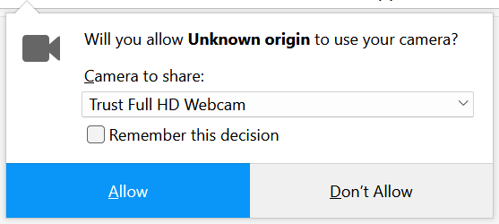

Hi Steve
Firefox ask for permission, and which camera
Edge ask for permission, but not for which camera
For the Edge The camera you can choose if you type in edge line_
edge://settings/content/camera

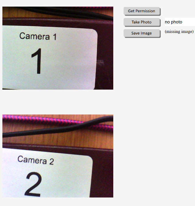

I added a second camera to the Web App
So I can use 2 cameras at the same time
“Record Video” will be missing soon :)
