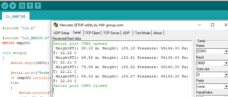

FYI : communication works but I get 0 for temp and value 0 for pressure, so something is not correct with this component. This sensor works correctlyIn Flowcode 8.2 .
Additionally this sensor (BMP280) has no humidity element, it has only pressure and temperature.
Humidity is in BME280
Working of sensor is confirmed using Arduino IDE.

Port is detected, but the output is still 0 from sensor.
I just tested it using sample code for IDE and it works ... so sensor is OK.
I have found something strange, If i click in gray area on Panel I got information like attached, SDA and SCL are still wrong (D3 and D4)... but in HX711 properties are correct (D4 and D5)
Do you have more idea what could be wrong ?
