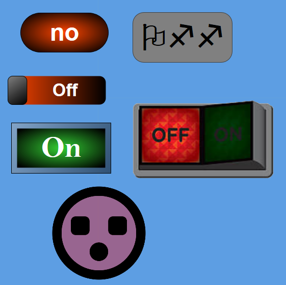

Here's some Flowcode switch examples I was working on earlier in the summer.
These are based on the existing switch component, but allow for full customisation of colours/fonts, use of images (external or internal), and optional 'thumb'. I have recently implemented switches with an animated switch action too.
These features kind-of exist in the latest v9 release, but are hidden as they are not finished and are being kept for v10. As a teaser, the following program should work in the latest v9 release. It shows these new switch types and shows how they can be used (at the moment, you can only interact with them using Flowcode's Built-in Function API calls). I'm sharing this here as a 'teaser' only and don't suggest you use these in your existing projects.

Re: Simulation push switch or slide switch
Attached is a very simple component that exposes the new hidden switch features. The component source is attached as well as the compiled component. This is unofficial and unsupported, but you can use it if you like.
Thanks for the switches. I would also need push buttons..
- Posts: 2031
- Has thanked: 302 times
- Been thanked: 471 times
You can use the same component without the 'thumb' and using images. That way you can make it look like a push-switch or whatever you want.
