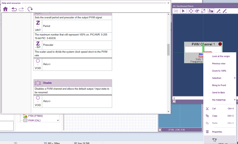

If you right-click on the PWM that's on the panel, then select help, you should see all the information within the Wiki.
It will allow 16bit as the period goes up to 65535, which is higher than the standard 10bit.
You use SetDutyCycle10Bit.

Thank you for the explanation - The help thing didn't run for me.

As for the help, it should open a new Help and resources window within Flowcode.

Lower frequency is due to having no clock input. The help button for that doesn't work for me. But I can always go to the wiki and search.
