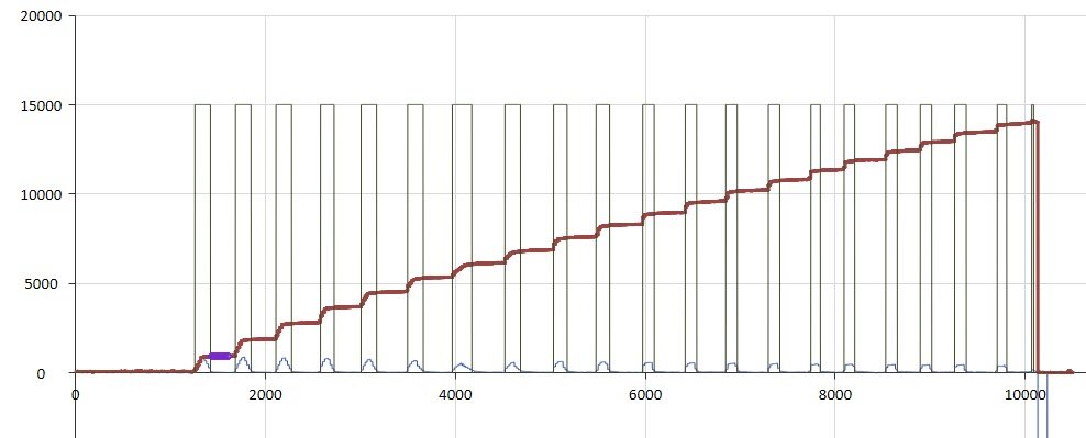

I have seen this also works with the chart. Can you also add an export all 8 series , or mark which series will be exported.
Sometimes I have very big charts

Yes - this will work with deployed App Developer apps as well. But only one series can be exported at a time.stefan.erni wrote: ↑Wed Feb 23, 2022 8:29 amThis is so good that it must also work in the finished App!!
i mean in the deploit(exported) App.

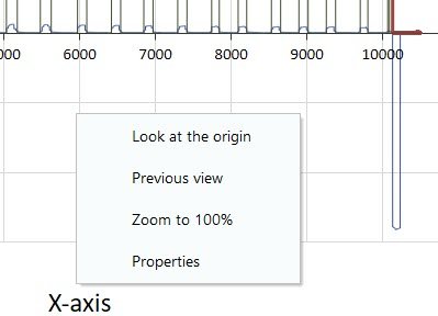

If it's working with deployed App Developer apps, how to do it there?
With the mouse-button I have just a zoom possibilities.

Hi Stefan. You are correct - it is not available in a deployed App. I will look into this and investigate.
