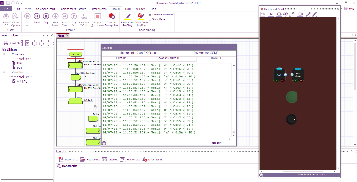

But during simulation, why do I see the data only as in the below picture and not as in the link below?
In the other tabs of the console is nothing.
https://www.flowcode.co.uk/wiki/index.p ... e_Tools%29

Running a simulation and viewing data via UART tab, which is data that was sent to the UNO and not the data being received on your PC, is not the way it works.

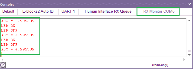

You will need to stop your simulation and select the properties of Serial Monitor component.
Change Refresh COM Ports to Yes, It will instantly change back to No.
Select the correct COM port for the connected UNO.
Either select Automatic or Manual Connection Type.
If the latter, select Open for connection.
If all is working the Data will appear within RX Monitor TAB, not the UART tab: If no data is within the RX Monitor tab then either:
You are not running the latest Serial Monitor component.
To update Flowcode, select Help, Library Updates...
Change the Files in-use to full database
If any components have been updated, you will need to select Reload for the effects to take place.
Or the port is already open, So removed the UNO, plug it back in and try all the above steps from the beginning.
Or you might not have the correct port selected.
Or the UNO is not transmitting data.
