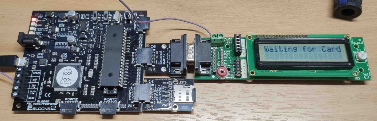

I’m trying to read a text file from sd card and display text on lcd display
The software works fine in the simulator but when I build and download to BL0080 pic programmer, eb005 lcd display on port B and bl0154 sd card on port c it starts off ok saying waiting for card but does nothing when I insert sd card with test.txt file on. Setup picture and Flowcode program based on program from wiki page attached

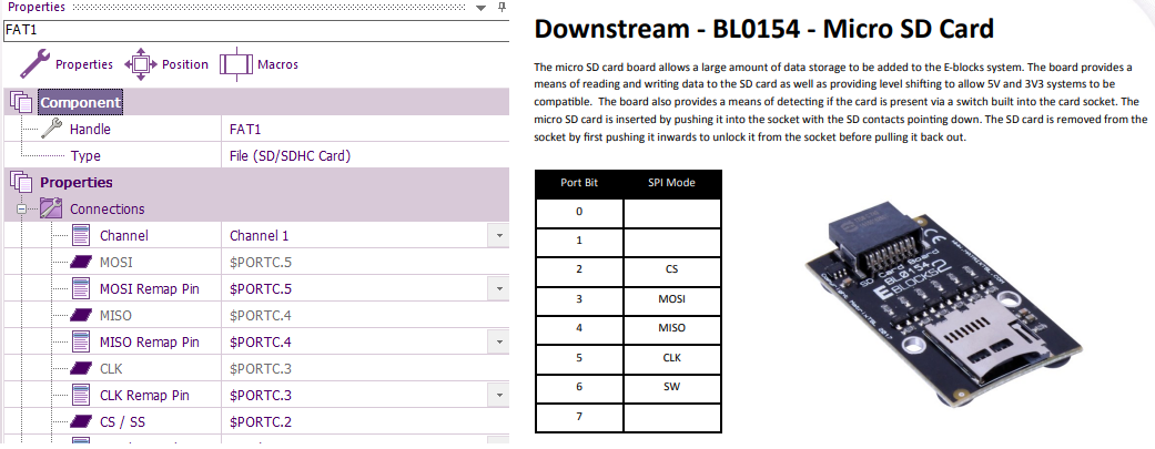

But, I have noticed within your property connections the reader does not match the settings within the datasheet: For example, you have got MOSI remapped to C.5, however, on the Eblock2 datasheet it's showing as C.3, etc.

The bits for the Ebock2 card reader are fixed and can't be changed.
Eblocks2 is designed for rapid prototyping.
The idea is you get the project to work and then you use your own hardware which can be connected to any pin of the microcontroller of course.
For example channel1 SPI, you can select MOSI to be assigned to pins C0 to C7 or B0 to B7, that is why the SPI connections going to the card reader are fixed.
Therefore you select the pins for SPI that are shown on the datasheet.

With the 16F18877 there are some peripherals that can be changed to work on different pins, there is not a dedicated set pin.
