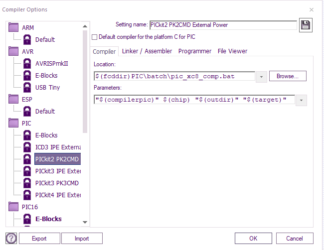

Your compiler settings are for the PICkit programmer and not the Eblocks2, BL0011 Programmer.
Can you go to Bulid>Compiler options.
Select E-Blocks within the PIC section and make sure the Default compiler for the platform C for PIC is ticked.
Then compile to your hardware again.

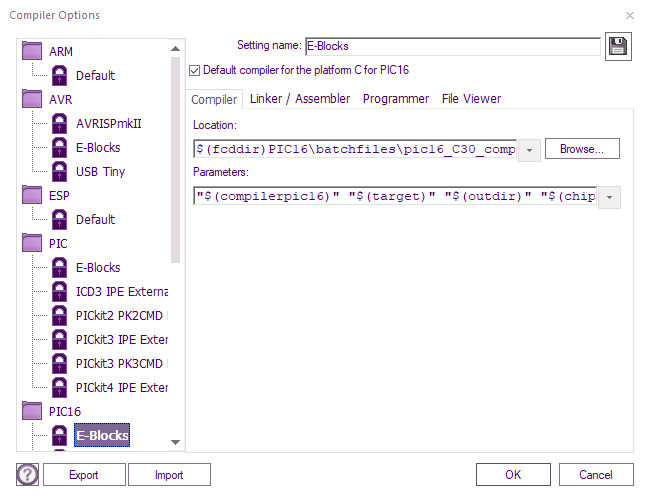

I changed the compiler option and selected the box i needed to tick, as shown in the photo. Once i press Ok and then open back up the options, it still defaults to the previous option. I tried to compile again and got the error message shown below.
- BL0127 Actuators Demo Flowcode9.2 - Copy (4) (1).msg.txt
- (434 Bytes) Downloaded 137 times
- Capture.PNG (37.02 KiB) Viewed 2987 times
- picture1.PNG (35.45 KiB) Viewed 2987 times
Re: BL0011
Nevermind, I realises i selected the wrong eblocks file, the code works as planned now. The only other thing i want to ask is , are there any files that can operate a DC motor on its own ?
