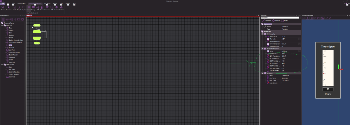

where to get this value ?
where to get this value.png (163.77 KiB) Viewed 2452 times

Re: help termistor setting 104GT-2
What I just did is enter the standard formula in excel for deriving the resistance for a given temperature.
These are the results:
R vs Temp 100k.png (9.57 KiB) Viewed 2429 times
You can either enter those values within the component properties or use one of the many online calculators, since the beta value is shown on the datasheet.
Another option is to use a formula to display the temperature.
I posted a project doing that, here.
