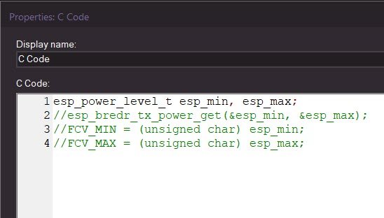

Hi Leigh
If I insert the first line: I can complie, download and the program is runing
If I insert the second line: I can complie, download and the program is crashing immediately even if I wait few seconds before the command

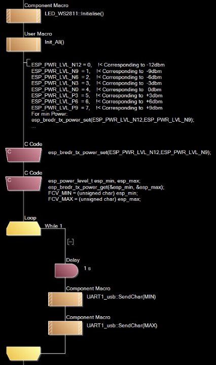

I'm getting a crash (abort) in function FC_CAL_RMT_TX_ (ESP_CAL_RMT.c line 115)
when called from LED_WS2811::Refresh, called from Init_All()
This is probably because you are calling the LED_WS2811::Refresh before the call to LED_WS2811::Initialise
Unless your crash log is different?
Leigh

Hi Leigh
You're right. The crash comes from the LED_WS2811.
Before I post the program, I created a macro and put all the init there. But in this macro the init from the LED_WS2811 doesn't work. I took the init back to main. Everything is fine again. Also both C command are working fine now.
I made some test and
Default powersetting is:
ESP_PWR_LVL_N0 = 4, !< Corresponding to 0dbm
ESP_PWR_LVL_P3 = 5, !< Corresponding to +3dbm
I have now set to the minimum
ESP_PWR_LVL_N12 = 0, !< Corresponding to -12dbm
ESP_PWR_LVL_N9 = 1, !< Corresponding to -9dbm
esp_bredr_tx_power_set(ESP_PWR_LVL_N12,ESP_PWR_LVL_N9);
I tested the power setting and sent it to the computer via USB and it seems to work.
I will now measure how long my device is working longer on the batteries
