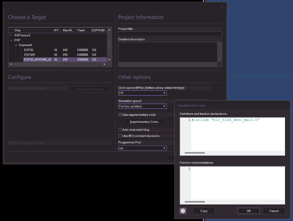

Hi Martin
Before I compile the Keyboard.fcfx
I would like to ask you in which folder I have to copy the file Keyboard.fcfx.
The program needs an include file "ble_hidd_demo_main.h"
Does this mean that Keyboard.fcfx .. should be copied to the same folder?
File it needs
folder

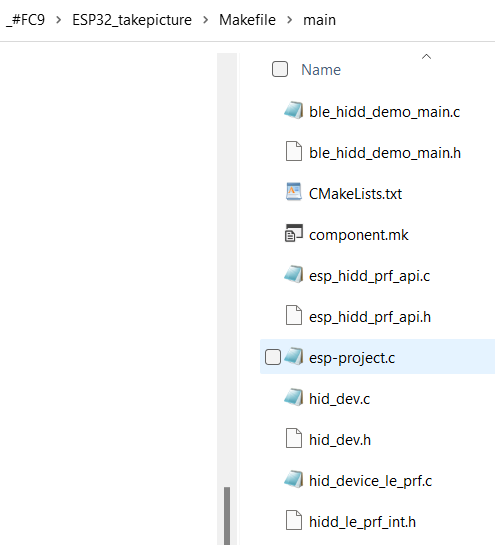

Hi Martin
Compile to C is working and give a keyboard.c
Firts time Compile to hex give a error but it creat the main folder.
So I copy the zip files in the main folder and
Second time Compile to hex run bether.
but still a little error

Hi Stefan,
You need to create the project file as per first downloads then update as per second.
1) save Keyboard.fcfx somewhere (say C:\Projects) open in FC and compile to hex (this will fail - no matter it creates the directories needed)
2) copy in the contents of the first zip (to c:\projects\keyboard)- and then contents of 2nd zip file to the directory (c:\projects\keyboard\main)
3) should now be able to compile to hex in fc.
4) upload using idf.py -p COM5 flash (change 5 as required for your com port)
If you pm an email address I'll send a 'complete' setup - it was too large to upload here even as a zip.
The errors indicate that the CMakeLists file isn't updated - see https://flowcode.co.uk/forums/viewtopic.php?f=3&t=1511 - where I break the steps down a bit more....
