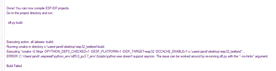

Made some progress today getting started with the ESP component.
Downloading/installing the ESP toolchain required a number of trials to find the right combination of versions of the ESP IDF and Python that would work together as coded in the install scdript.
Turns out that IDF V5 and Python V3.7 are willing to jive together.
Initial test compilation worked but then failed on the build, see attachment.
I really don't know what I should do now, please advice.
Jan
Jan
- build.PNG (21.11 KiB) Viewed 12805 times

Hi Martin, thanks for chiming in.
I looked at your pointer as well as to Ben's inputs on this, but these appaer a year or more old and I have anyway no more problems with installing and compiling after figuring out which versions to use.
The problem I have is after a succesful compile, the build fails with the meassage:
ERROR: C:\Users\jandi\.espressif\python_env\idf5.0_py3.7_env\Scripts\python.exe doesn't support asyncio. The issue can be worked around by re-running idf.py with the "--no-hints" argument.
Will that be cleared by following the (tricky, by his own words) process described by Ben?
Also, how do I "Go to the project directory and run: idf.py build" ? I'm sure its trivial ...
Jan
Jan

Re: Architecture advice please?
Hi Jan,
ESP IDF version 5 cannot be used (with Flowcode).
This is causing the problems. The build is not successful.
Please read Martin's link carefully
