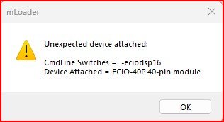

ECHO40P flashes for about 10 seconds and then the LED lights up constantly....
look here:
Look here:
See here too: C:\Program Files (x86)\Flowcode v10\tools\mLoader\mLoader.exe reported error code 0x32

Hi Monie It looks like you are selecting the wrong device.
You need to have the 8bit PIC Toolchain and Select ECIO40 for the target device.
It looks like you are selecting ECIO40P16 which is not 8bit ECIO40.
I assume your hardware only has ECIO40P and not ECIO40P16?
They use two different types of microcontroller.

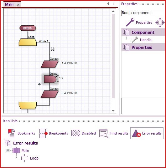

Although I use 8 bit ECIO40P Compiler messages work, error message comes.
When compiling get notification = Error results: Look here: Flowcode v10 code: Have also tried with ECHO BASE BOARD and with Led Board:
1: E-blocks application board - EB061
2: Matrix EB004, E-Block LED Evaluation Board
3: ECIO40P
But no luck getting the devices above to work with flashing links

First, why don't you answer what Martin and all other who want to help you and tell you, or ask what to try and do?
The picture you have att. is not the same as the program you also att. When I try to program your testprogram, it compile by me as it should, no problem.
Have you installed the Toolchain as Martin suggest?
I have att. the USB driver (older) you also need for compiling. Try to install for both the 28 and 40 deviceses.
With my testprogram the led D1 on the Eico should flash with one second, and work by me. After press compile you have to press the reset on the Eico.
Br Jorgen
