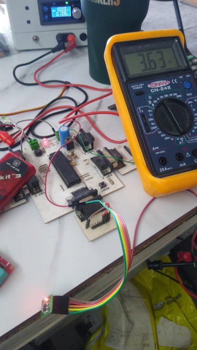

Ok just updated, It continues to remain unchanged, it does not increase or decrease; In simulation it works.
Enrique

Did you reload your project and recompile to the target device, after updating the component database?
If you did then I will order one and see what the issue is.
It was strange as I was monitoring the pins and they did look correct with the updated component.
Can you also remove the power and do a continity check between the microcontroller and digital pot pins?

Check continuity of each connection from the sensor to the chip pin, Vcc and Gnd connection, turn it on and off repeatedly, also use the PIC reset, maintaining the original connections to rule out a bad connection. I saved the new component (sensor) in Flowcode 10 Components, removed the Flowcode 10 program from the laptop and opened it again, made the program from the beginning using the new component that was incorporated, simulated it correctly and copied it to .hex (the sensor X9C103 I unpacked it new).

However I will continue testing to see if the error appears, I will keep you informed if there is any news.

I'm going to check everything and use a new potentiometer and I'll let you know the results.
