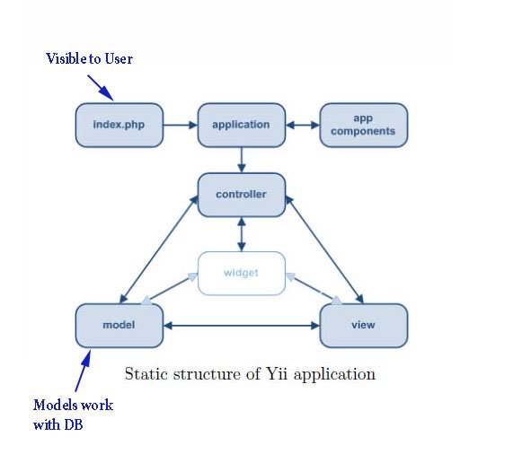

I am not sure how much time do you have.
The Yii framework is based on PHP but the benefit of it is: it creates a lot of code automatically.
You have to fine tune this code (if you need to) later.
I did the project a few years back and don't remember the details.
In my case Arduino saved to sd card the CSV rows.
Syntax of CSV should be exactly the same as MySQL table syntax.
If it is, you create the cron job and the table data will be aupdated automatically.
It is a bit of a work and some time to be spent.
I think it is the OOP- object oriented programming.
Please read more about yii.
