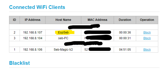

Wifi Client.png (19.53 KiB) Viewed 8242 times

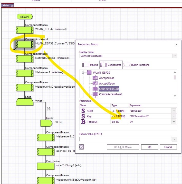

You can try with this prog, it's for TTGo but you can change the Target device
ESP_Webpage_TTGO_SEB TEST.fcfx
(15.76 KiB) Downloaded 884 times
need to change SSID and PW
then compile

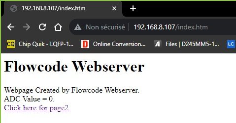

wait for the connection to router and look the IP address of you ESP32
then you can open webpage and type the IP address of your esp32
