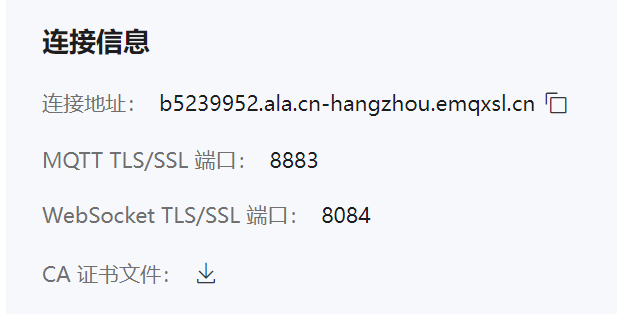

I have managed to use your credentials to successfully connect and send/receive MQTT messages using Flowcode Web Developer. The project is attached. So there are no issues with the authentication, etc, so the properties you are using in your embedded project are correct.
IMPORTANT: As the attached is a Web Developer project, it uses WebSockets and so I changed the port to 8084. Your embedded project should use the MQTT protocol directly on port 8883.
