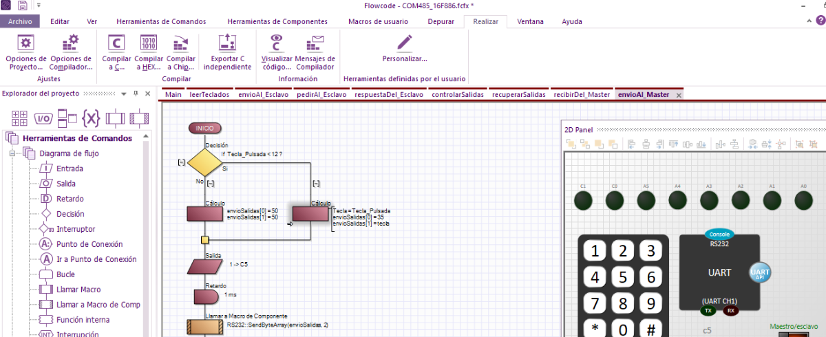

Re: Compra de Flowcode
The one located when the reported problem occurs.
It always happens to me that after making some change to the project and I click compile to hex.
At that moment I get a warning indicating that the project is not saved and that it will be saved before compiling.
When you click OK, the project is saved, the compilation is carried out and it is at that moment that the "*" indication appears again, indicating that the project is not saved.
Attached is the image capture and the project file is the same as the one attached previously.
My operating system is W11
- captura 1.png (264.66 KiB) Viewed 7029 times
I have tried again following your instructions and it does not show the asterisk after compilation.
Does this happen for you when you do *any* edit to the project, or is there a specific edit to the project that causes this problem?
And are you using the latest v10.1.0.38 with the latest library updates?
